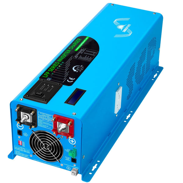

I know my TP6048 was/is extremely top heavy, I'd say 95% of the weight is in the top of the unit. SGP stated it is LF when I asked them through Amazon questions and direct email. I also know the led lights pulse/flicker when the washer agitates and the inverter is running off battery/solar, but it starts my 1hp pump ( that I clamped at ~40a ac per leg) while running the rest of the house.
I completely agree it isn't tier 1 and never will be at the price point it's offered, however I'm beyond satisfied for the $1400 shipped to get my feet wet and give 1 finger to the poco. My next move, to give 2 fingers, will be an XW6848 Pro along with more solar and batteries. Heck, I might not even need the batteries with the efficiency savings from the Schneider ?.
Note, to stay thread related, my TP6048 is around 136w idle when connected to utility. Iirc the manufacturer spec (once you dig it up) is 135.

The term "high frequency" can be confusing. 99.999% of sinewave power inverters these days switch at high frequency. HF
Sinewave inverters that use the big heavy 50/60 Hz transformers are usually referred to as LF inverters. Inverters like Victron, Magnum, OutBack, Schneider, SMA, Trace, Heart and the other "heavy weight" inverters, all switch at 20 kHz or higher (so you can't generally hear them) and boost to 120/230 VAC with that big low frequency transformer. The only exception is a modified squarewave inverter.
A true low frequency SW inverter would not only use a heavy 50/60 Hz transformer but would also drive it with an amplifier like for audio with a 50 or 60Hz sinewave oscillator. No switching involved. But that would be much less efficient.
