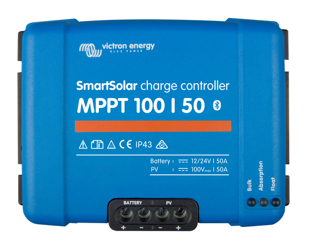

For the MPPT controller, it's rated at 50 amps, and will limit its output current to 50 amps. Technically by NEC requirements you can use a 50 amp fuse, but I prefer a little bit of headroom to prevent nuisance blown fuses/tripped breaker and would go with 60 amps, if available, but no bigger.

The solar regulator and fuse box need AWG 8 or 6 , fused at 50A or 60A.

Cable size for positive and negative, inverter, AWG 1 or AWG 0 for long length, Victron MPPT, and fuse box AWG 8 or 6.
Note when connecting up for the first time ensure the Victron controller is powered up before connecting the solar panels to the unit, this is needed so it 'learns' the system voltage.

The mppt controller victron smartsolar controller,
