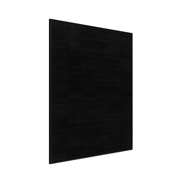

I am planning to head down to Richmond next week to pick one our two of these panels up to mount on my shed roof and power my 767. Thanks for the info watchdoc! Couple of questions:
-Would there be any serious disadvantage (besides the obvious) to running just one of these panels? My wife might not allow that much panel in view of her kitchen window as that will overhang the shed roof a bit.
-I know you said bifacial panels aren't ideal roof mounted, but we are fairly limited with the 767's solar input specs. Considering the limited options, would you recommend anything else for a roof mounted application? Thanks again!
A single panel would be fine. Bifacial panels are just heavy and expensive. You might be able to come up with a cheaper mono panel or combination of panels for the given space that you have available.
Thanks for the input. The shed roof it 8'x6'. 400-500w (if I got that much roof mounted) for $300 or so might be hard to beat tough. Plus the simplicity of it.
Looks like Richmond doesn't have the 480w panels but they did suggest some physically smaller (which suits my shed better anyways) 400w panels also by Q Cell. The thing I worry about is the VOC is only 45v and the MPP voltage is like 38v which starts getting down towards the 32v limit. Thoughts?

Just found these used local to me for half the price. Should be a little better with the 400w Qcells considering the higher watt rating and higher VoC, right?
