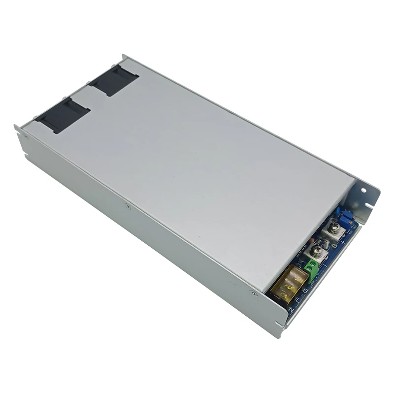

Hardware wise, there’s no reason why that can’t be supported via the Extra Battery post, which is a two way DC-DC port with data. But EF has to write the firmware feature for it. Maybe they can add it later if there is enough customer demand.
In the mean time, you can daisy chain them, but you will lose efficiency (due to extra inverter being on and extra AC/DC conversions). So what you can do is something like this:
AC outlet -> DP1 -> AC-DC SMPS -> DP2
AC outlet -> DP3 -> AC-DC SMPS -> DP4
Then DP2 + DP4 could connect to a Double Voltage Hub

Battery chargers like that need to directly connect to the battery, not be in series with another charge controller. They will likely fight each other.
These 2 SMPS have been tested and is in use by multiple users in the EF community:
The first one is higher powered (on 240V input), has active PFC, and can be toggled using its toggle terminals, but takes 6-8 weeks to get there.
The 2nd one is lower powered, but can be had in under 2 weeks.
But where could I get my battery bank in the middle of all this with out messing things up ?
Would be nice to add them for more power 7.2kwEF + 7.6kw battery bank. x2
AC outlet -> DP1 -> AC-DC SMPS -> Battery bank 2x12v S or P for 24vdc or 12vdc -> DP2 DC input
AC outlet -> DP3 -> AC-DC SMPS -> Battery bank 2x12v S or P for 24vdc or 12vdc -> DP4 DC input
I like your recipe
You can make this work if you really want to, but personally I wouldn't. You've now made the system way too complicated. If you are introducing your own battery banks, you might as well go with an all-in-one inverter charger like Growatt or MPP Solar, and leave DP out of the chain. Setup would be a lot easier, and there will be a lot fewer places for things to go wrong. Less is more. So either stick with EcoFlow ecosystem, or roll your own DIY system.
But assume you really want to make this work for some reason:
AC outlet --> Battery Charger for your battery bank --> Battery bank 1 --> DC Boost Converter (need to boost the voltage if you want more than 200-400W charging speed) --> DC output to DP 1 DC input --> AC-DC SMPS --> DP2
AC outlet --> Battery Charger for your battery bank --> Battery bank 2 --> DC Boost Converter (need to boost the voltage if you want more than 200-400W charging speed) -> DC output to DP 3 DC input --> AC-DC SMPS --> DP4
I would encourage you to not go down this route. Not only is this way more complex than it needs to be, you are going through extra conversion steps that lowers your overall efficiency.
