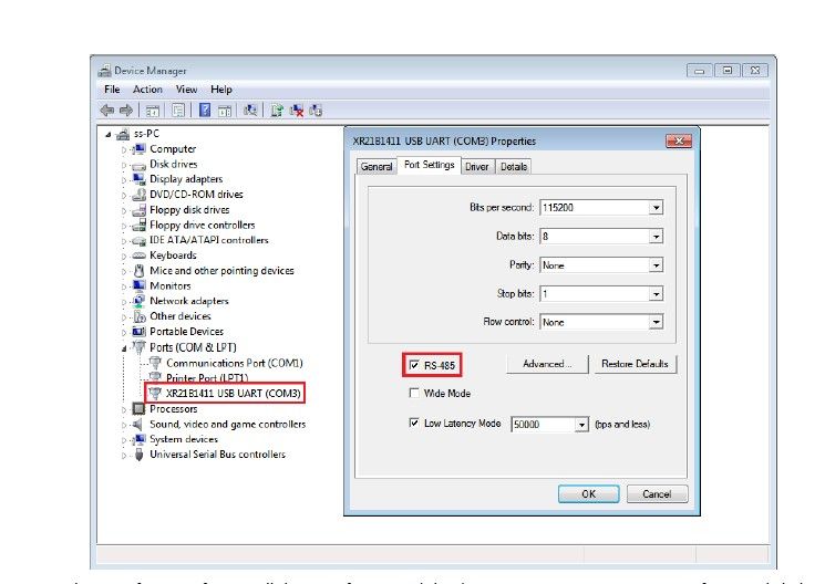

Found it...attached is the instruction manual for the software - it gets downloaded with the zip file with the app/program.
The second and third page has the driver setup for the USB port - you must activate communication by RS485. It is described and images confirming. I remember having to do this in order for the port to use the cable.
The device settings for USB also lists the uart driver for the com port, indicating which port it installed on. The assumption is that it's com 3, as the other two are likely default reserved for something else. Anyway, it's all diagrammed there, that should fix your connection to your controller.
You did get the proper RS485 cable and plug it into an open usb port on your computer, right?
It also details the parameters settings read and update process as well. And it's important to use the 'for lifepo' parameters as that turns on or off things specific for charging a LFP pack.

Did you check the box for RS485 in the windows device settings for the port your cable is plugged into? This is NOT done in the program, it's done in windows devices for that port.
Likely it's Com 3, so trying to connect on com 4 is not going to work. Open up your device settings for windows as the manual indicates, navigate to your USB ports com 3 for UART, right click to open settings, the second menu is port settings - checkbox RS485.
ADD a device in the EPEVER program for com 3. You might want to delete all the non-working ones you have setup already, just to declutter.

Here's the image out of the manual showing the RS485 check box in windows device manager. And we see that com 1 is reserved, as is com 2 for printers, and why the usb driver generally gets installed for com 3:

Your third image is the right port setting window for windows OS - but for which port? The device manager list is out of frame.
Your fourth frame shows you setting the program port settings for com 4. Unless your usb driver was installed for com 4, it won't work. Show us your device settings for usb ports.

Ok,, i tried something and success,,, the USB to RS485, of the 2nd unit must be bad, because i just had the idea to use the one from 1st unit on the 2nd unit, just to see what happens.. I successfully programmed the 2nd unit... And i am able to see info in the monitoring.. .but i cant figure out why I couldn't see monitoring in the 1st unit a while ago.. Hmmm

I'm a happy camper now, it seems the adapter was the problem the whole time.. Now to see how i can get the program to work on my home laptop again.

The thing was, i have 2 USB RS485 adapters that came with the units. As it was, one was COM3, the other was COM4. and after all this farting around for hours on end i discover that one of them is bad.. I thought it'd be easy to just leave them connected to the CC, so in case I ever wanted to connect to them, i wouldn't have to remove the covers to connect the adapters. Just plug in the USB and go...
