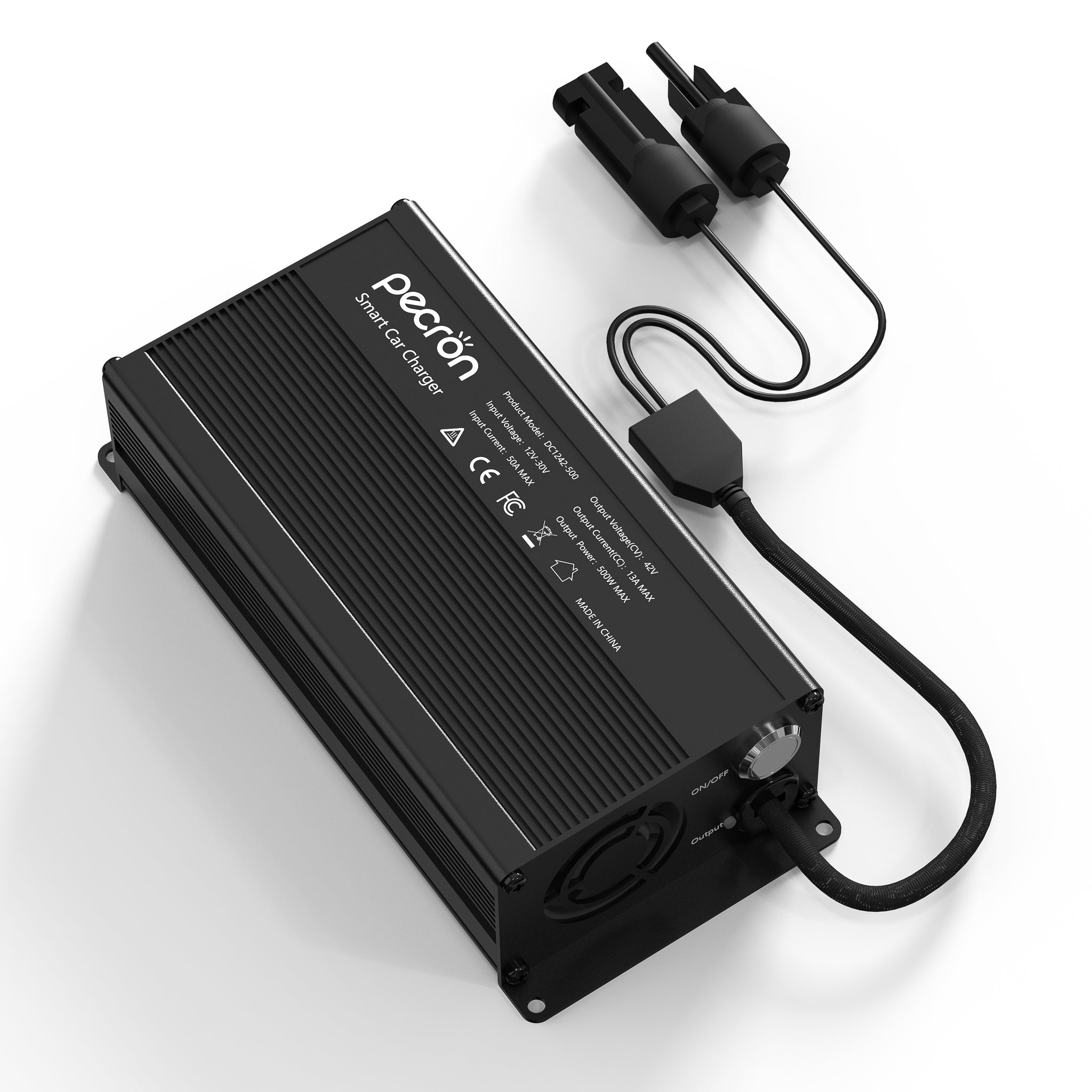

SEE UPDATE BELOW!!!!
After watching the operation and performance of the Pecron 500w DC 1242-500 And weighing the pros and cons, extra features and price difference of the Ecoflow alternator charger vs the Pecron I canceled my order for the Ecoflow and ordered the Pecron for $134 no taxes after discount Compared to the Ecoflow that was $425 after discount and taxes. Couldn't justify the cost and need of the added features.
I can still monitor power output and battery voltage and other parameters from my D2M Ecoflow app.
It is a relatively new device and hope dependability and quality is up tp par. But saving $291 I feel it might be worth the risk. I could buy two more for other uses and vehicles and still be ahead.

Whaaaat? Thanks!! This does not show up on Victronenergy.com, nor on any of the dc dc pdf product charts they have. AND I went to the Victron booth at Overland Expo West, and THEY said they didn't make a 12 to 48v!
I think I like this better than the Pecron offering, just a bit more $, and I can boost to higher voltage.
https://productimageserver.com/literature/ownersManual/103414OM.pdf check page 2 second table. Looks like its actually adjustable 60V output as per spec (which I trust) expect 380W under normal conditions. its going to be extra hot.

Didn't you receive their notification email? I received this email on the 24th of May.
Similar to this one:
A note for 500W car charger​
We are very sorry! 500W car chargers are very popular. Orders placed in mid-May need to be queued for delivery. They are expected to arrive at the CA warehouse next week and will be shipped one after another.
Orders starting from May 26th need to wait for the third batch of 500W car chargers to arrive at the warehouse before delivery. The third batch is expected to arrive at the warehouse at the end of June.
(Sorry that due to system reasons, the notification email we automatically sent to customers seems to have failed to be sent, apologize!)
Therefore, we will still maintain the lowest promotional price during this period, and we will end the promotional price after the normal inventory is restored. Thank you so much for your support!​
