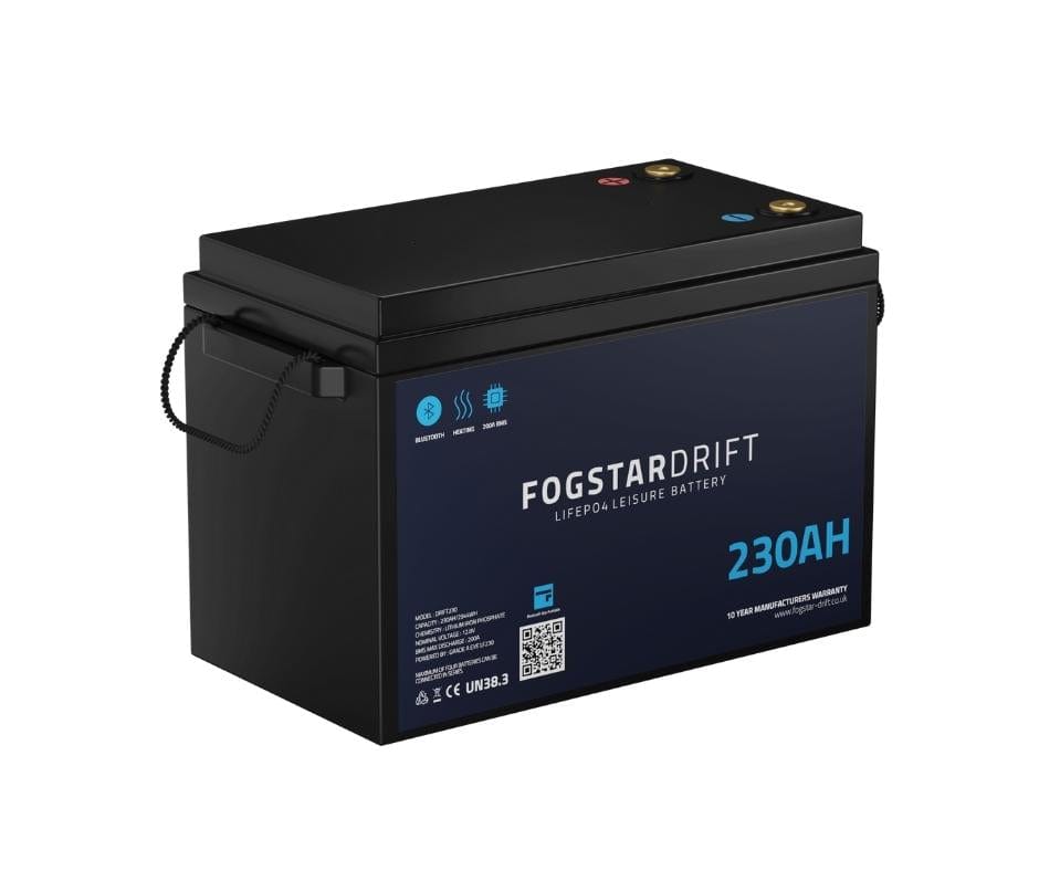

Battery prices in the UK for a quality deep cycle LA are quite high. Most of the so called deep cycle leisure batteries are starter batteries that have a much lower cycle life than claimed. It's probable a 200 Ah lithium battery will meet the OP needs.
The similar capacity AGM assuming a 50% discharge needs , 450 Ah, 3 off 150 in parallel
Lithium cost £720, AGM cost £600
