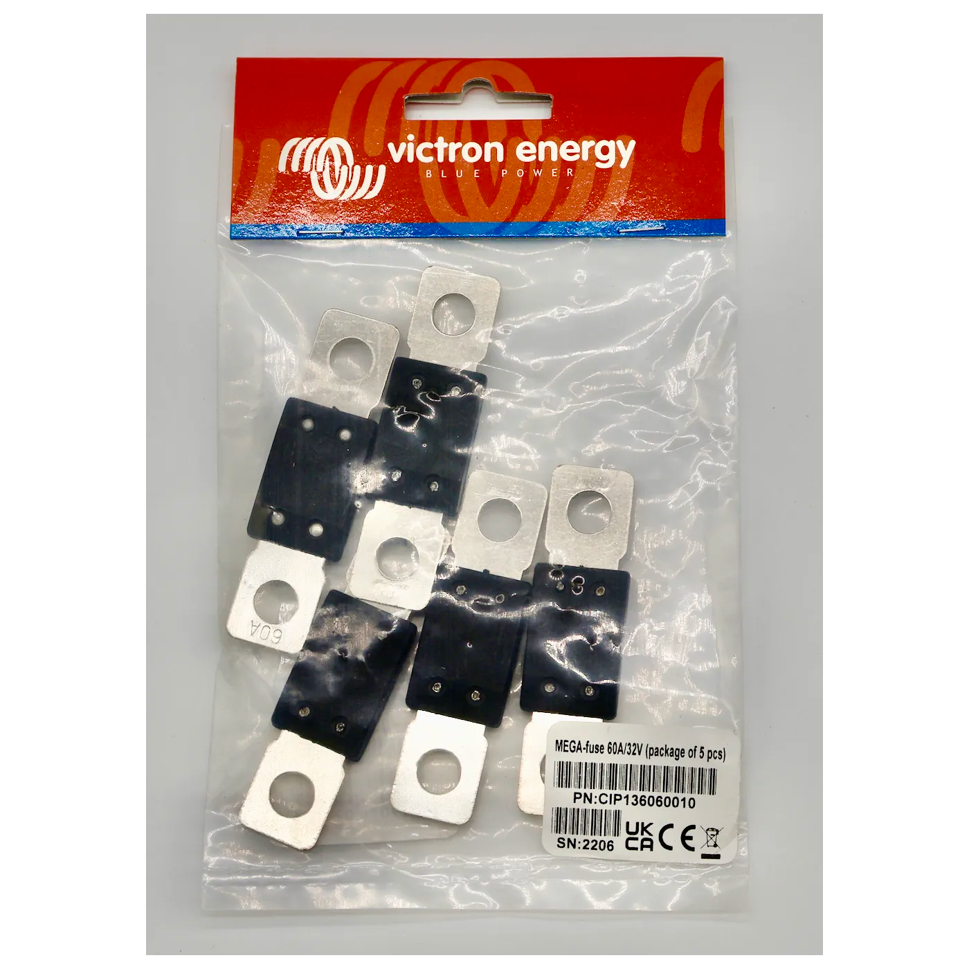

The fuse picture i posted was just an answer to the "what is a meltfuse" question.
The exact fuse was a mega 48v, 300 A.
Can it be, that the battery was 48V nominal too?
Such batteries go wide over 48V, up to 58V regularly when charging and possibly, even much more for a few ms when the fuse blows under full load.
That is more than enough to start a DC arc, which is specially hard to extiguish.
I think, the fuse should be rated 64V-DC. at least.
DC is weird.
