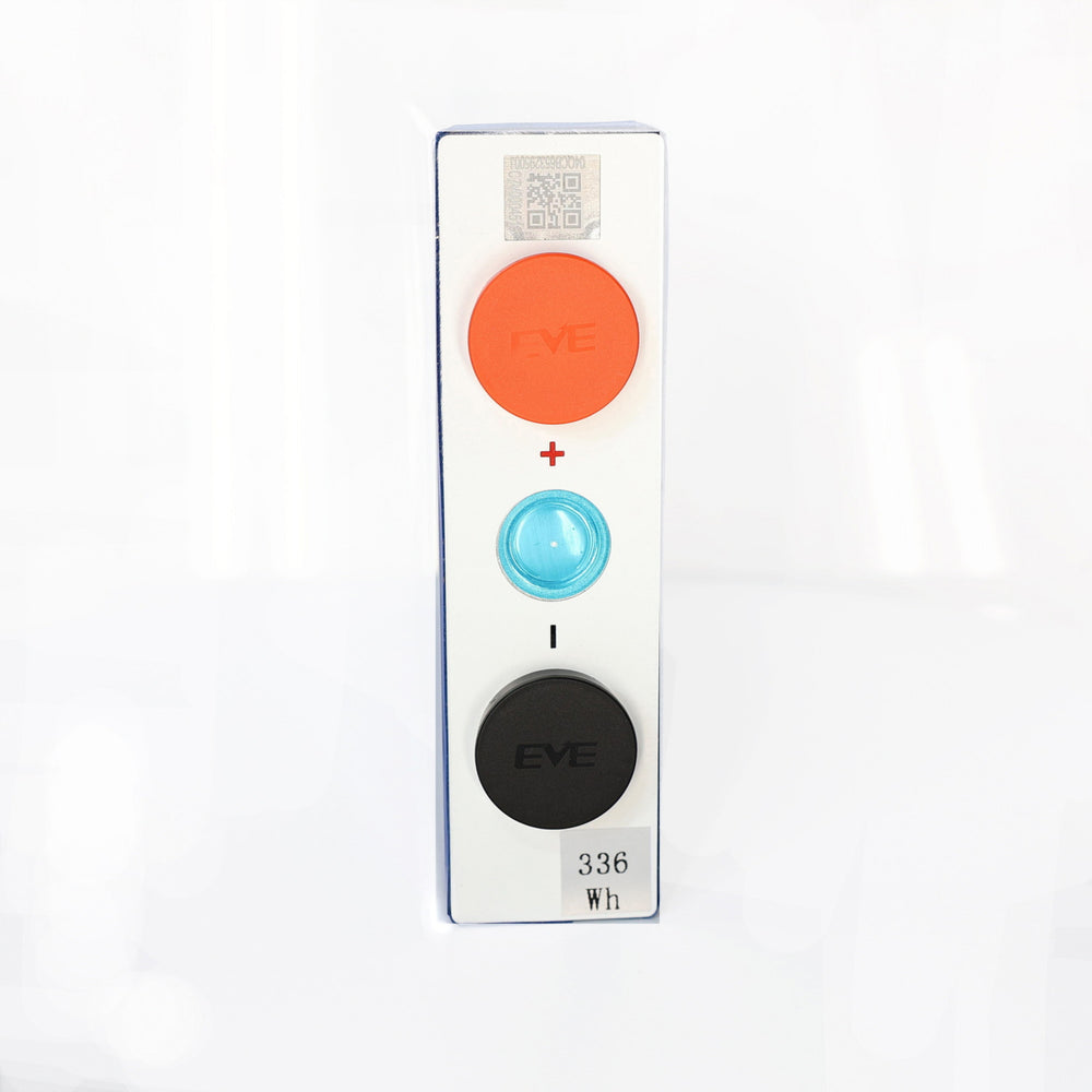

B on the QR code of the cells look to be EVE cells. Balancing will become an issue in the future, I would get an active balancer.
Pretty much confirms all varter are grade B cells.

Suspect they sanded and put fake qr codes on the cells:
kind of looks like sanding marks, if they are real then this is a problem where customers get grade B but youtubers get real cells.
Suspect they sanded and put fake qr codes on the cells: kind of looks like sanding marks, if they are real then this is a problem where customers get grade B but youtubers get real cells.
That is very concerning if they're going that far to be deceptive. The cells I have seen that have scratched QR codes usually look like someone used course sandpaper on them whereas these are very, very fine. I don't think they are sanding marks but obviously can't guarantee that. They could be B-grade, which would explain the capacity test results 🤷‍♂️

Also here are some QR codes from EVE 230 18650batterystore and under the label, no signs of sanding:
Look at this guy he got the same bat but it had the B on the qr code intact (I time stamped it so you don't have to watch whole thing):
There appears to be something fishy going on here for sure. I will follow up later this week. In the meantime, I reached out to them to see what they have to say on the matter.
I pulled off two of the black covers and here's what's underneath. Something still looks a bit off but I'm not sure enough of what's going on that I am comfortable making a video discussing. I don't believe they were sanded, but for some reason it seems the glue was removed around the code and there is black stuff on the edges of both. It looks like the area may have been polished - perhaps before etching a new code? I really don't know... Other areas of the cell have the same questionable lateral marks (3rd picture).

The manufacturer replied twice and stated the following in reference to the question I asked and a picture I sent of the aforementioned video of B-stamped cells.
Thank you for your reply, we currently do not have B grade batteries. All battery's are eve's A grade cells.
Our QR codes are not scratched off and re-laser engraved.
The QR code in the video has scratches supposedly from a sponge or something else.
This battery was developed at the time of technical evaluation used a small batch with B characters (not meet the use of automotive battery cells, fully applicable to energy storage batteries) of the EVE clls, in October 23 mass production has been upgraded to all the A cells.

Also you have to fully clean the terminal to see for sure:
Without being able to see what is around the edges of the cell you will not be able to tell, it takes a while to clean with rubbing alcohol. See attached images only when the full area is clean can you see the parts that were sanded.

See that's the thing though, mine kindof look like your docan picture. I can't get the glue off. I tried soaking it in IPA and it didn't really loosen up at all. I gave up, but I did get the cells pulled out and they look very nice. They're flat (no bulging) and all have test stickers from Oct 2023 at 232Ah. Done fiddling with them for now. I'm considering picking up another battery and building a 16s pack out of them.
I followed alkaline's advise and cleaned my cells to verify. I see he used my image of the 18650 cells. Naughty. 🫠
It takes a while but he is right they should be clear from end to end:
