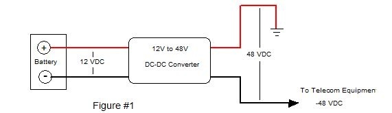

Power system includes Min. 1200 A @ 48 V DC lithium technology battery storage and min 8.kW Solar Panels. We need to be able via generator or solar via batteries make 48 V output DC supply 6000 W (DC/DC stabilized) 24/7

Sounds similar to telecom applications. There should be packaged solutions from that industry. Much of what comes up is smaller.
Is -48VDC OK or do you need floating or positive?
Can you equipment handle 48 - 58Vdc range? Usually 48V nominal equipment has internal dc-dc converters that can handle wide range of input voltages but are often limited to +/-10% in firmware. If you can get your gear to work up to 60V then you can forgo having to place intermediate dc converter between 16s LFP battery and your equipment. Easier and more efficient.
There are Pylontech US5000 batteries using 15S LFP cell stack that have 46 - 52V usable voltage range within 5 - 98% SOC. Most 48V equipment should be happy.
