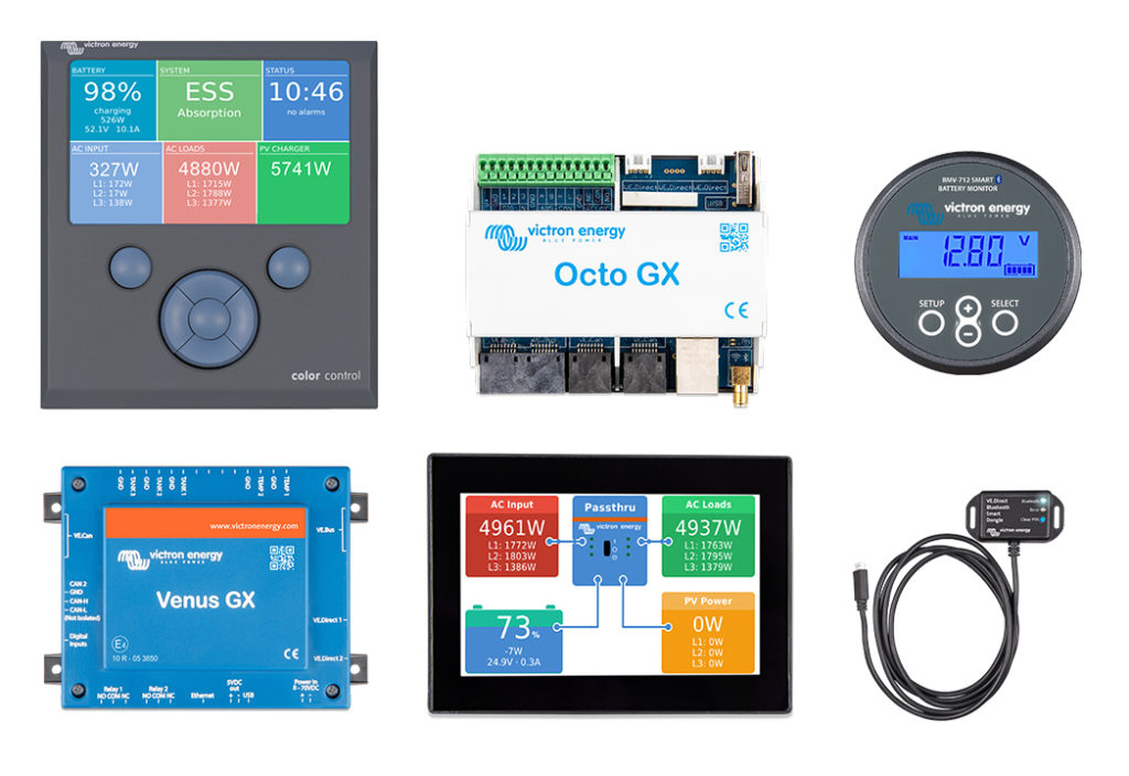

The 712 has its own little display that plugs into the shunt. (I forget how long the cable is). You do not have to have a smartphone, but it can talk to a smart phone.
Since you won't be using the bluetooth functionality, you may want to consider one of the other victron BMV70x models. Depending on how you wire the batteries, you might want to consider the BMV 702 so you can monitor the center point voltage.
This blog talks about the various models
The BMV range consists of products with BMV-7 in the model name; earlier versions had a 6 prefix. Below I highlight the differences between the various current models – so you can be sure you choose the right one for your application and budget. The range consists of:
  • BMV-712 Smart (6.5 – 95 V, 1 – 9999 Ah, Bluetooth built-in, Auxiliary input)
The models below, without Bluetooth built-in, we collectively refer to as the BMV-700 series:
  • BMV-702 (6.5 – 95 V, 1 – 9999 Ah, Auxiliary input)
  • BMV-702 [Black] (6.5 – 95 V, 1 – 9999 Ah, Auxiliary input)
  • BMV-700 (6.5 – 95 V, 1 – 9999 Ah)
  • BMV-700H (60 – 385 V, 1 – 9999 Ah)
