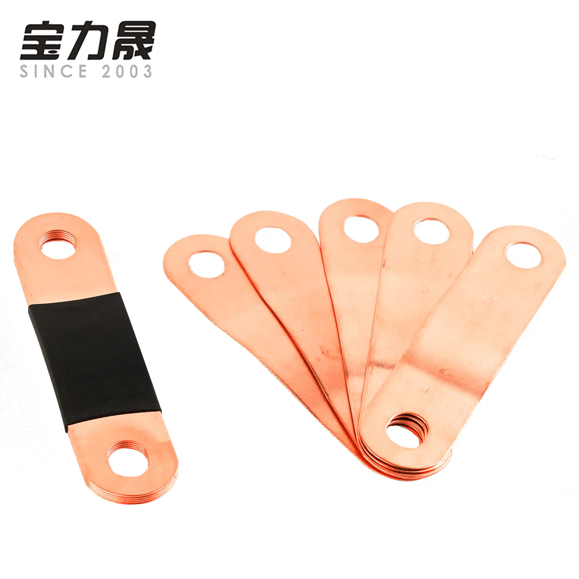

Everyone keeps referencing 300Kgf and 661Lbf, but what I really want to know is how many Stones force we are talking.
So Gazoo,
Given the price of braided busbar, why would you not just use 1/0 or 2/0 gauge Wire ( I would think cheaper)? Not sure why everyone is so welded to solid bars? (yes pun intended) (ducking quickly)
Sorry, I just saw where you mentioned short flexible cable! (palm planting face). Still a valid question at the end though, what makes everyone like solid bar so much?
My guess is simplicity (as in its just a piece of copper, its cheap, and they usually come with the cells)
Short, large AWG cable seems common for connecting a bunch of LA batteries, but with the high number of cells and very short distance between cells, large gauge wire seems like more trouble than flat bars, braided busbars, or the CALB style busbars (which I think are a balance between simplicity, cost, and tolerance)
This is a CALB style busbar:
Copper BusBars Interconnect For lithium 3.7V CALB CATL 3.2V lifepo4 battery  for 100AH 80ah 120AH 150AH 180AH 200AH 280AH 300AH|Replacement Batteries| -  AliExpress
The left and the right are the same thing (the right side is just deconstructed) the CALB bars are many thin layers with some curvature to allow some small amount of flexing/expansion.
Here are CALB style busbars next to some very high quality looking braided bars.

Yes, I believe he’s considering stranded bus bar mainly to provide flexibility for swelling / reduce mechanical stress on terminals.
I don’t know about conductivity of stranded busbars versus solid but what I do know it that a solid copper busbar of sufficient thickness will be able to handle peak currents required and this is very easy to calculate / check (plus they are less expensive than pretty much any other option).
