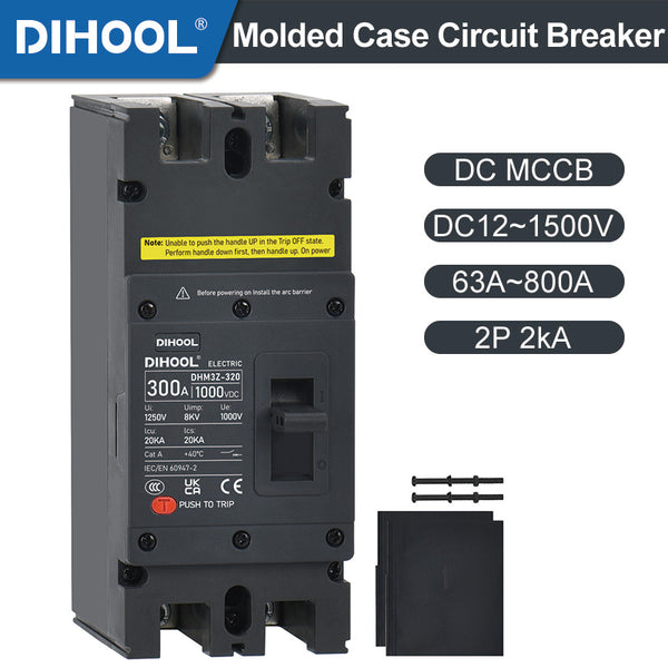

Looks like a knock off of a wearing house breaker
The ratings are a bit Suspect
It’s an iec breaker
Nothing wrong with that
When evaluating DC breakers, the first thing I want to see is a test lab marking or report.
If not UL, at least TUV or other European test labs. Actual test reports are a bonus.
CE/UKCA markings can be self-certified, there is no enforcement other than requesting to see their file of documentation.
CCC is the compulsory communist Chinese marking for safety. You can be the judge of that.
If it says IEC/EN 60947-2, it has been certified by someone to meet that international standard (which is good).
