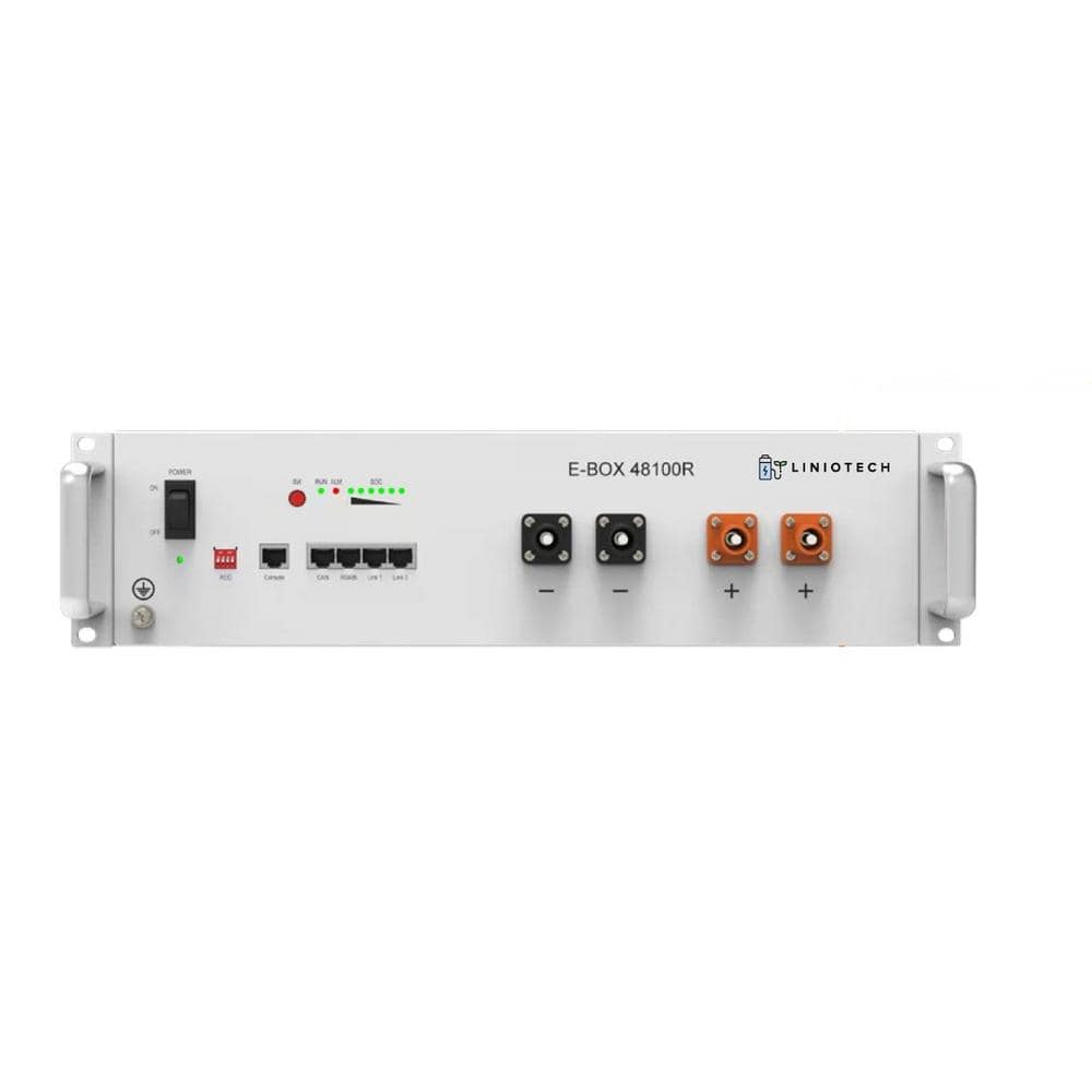

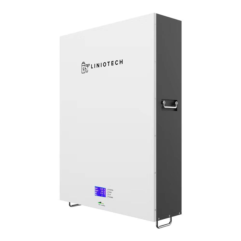

Just ran into this third outdoor LFP offering from Linotech: https://liniotech.com/ul9540a-ul1973-ce-emc-ground-outdoor-power-storage-wall-ltn14000u/
$3799 for 16.38kWh and UL9540A certified…
$0.232/Wh (new low in the outdoor-mounted weatherproof class…).
105.6% the price of the EG4 Power Pro for 115% the capacity.

Interestingly they are sold at Home Depot although pricey.
On there web site they claim to only use CATL
