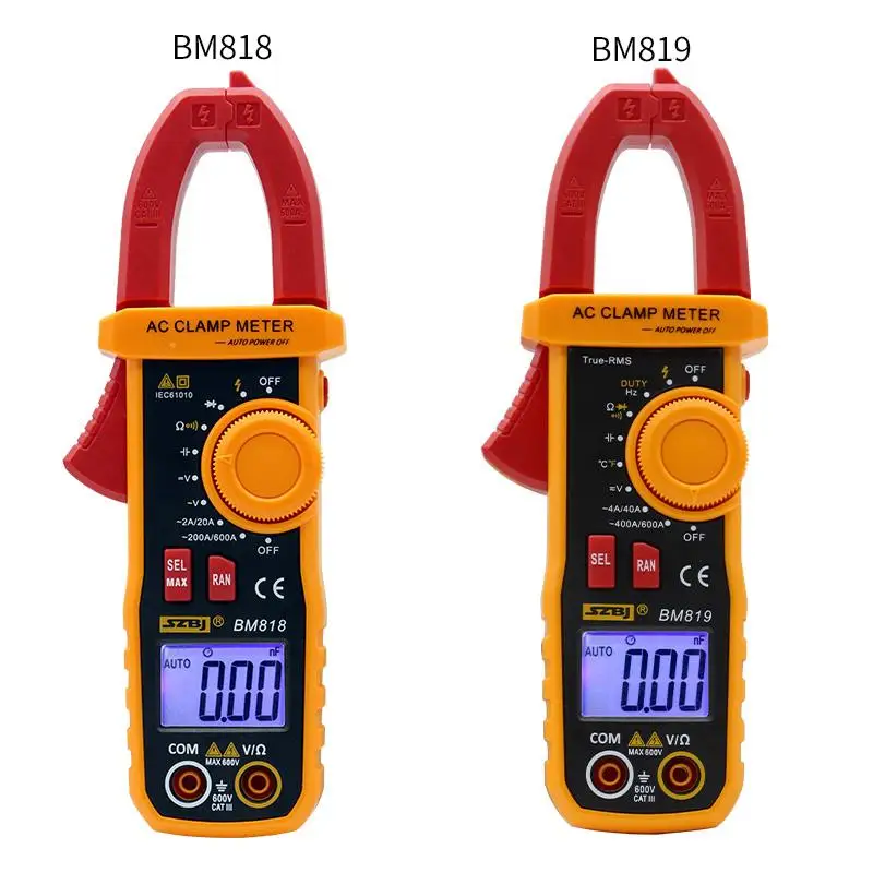

I have the BM819
BM819 true value digital clamp meter
1. automatic range measurement
DCV:400m/4/40/400/600V,
ACV:4/40/400/600V
ACA:4/40/400/600A,
Resistance: 400 /4k/40k/400k/4M/40M Omega.
Capacitance: 10n/100n/1u/10u/100u/1000u/1mF
Frequency: 100/1k/10k/100k/1M/10M/40MHz
2. true value of AC value measurement
2. can accurately measure the AC current of AC20mA to 600A
3. the capacitance value below 10mF can be accurately measured and the measuring speed is fast.
4. has the functions of temperature, frequency and duty cycle measurement.
5. use NCV induction head to judge phase line to accurately measure current.
6. has the function of diode and short circuit beep alarm
The 7. diode can measure the LED operating voltage below 3V.
The 8. backlight is easy to read in weak light environment.
9. has a readable retention function.
10. there is a manual range function
11. automatic shutdown function can be set up or not.

That can't read DC amps with the clamp. That's the problem with 99% of the cheapies.
